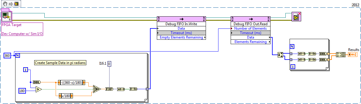

Here are some graphical images for what Jim is talking about.  The FPGA does a simple sin/cos calculation (the FIFO Read/Write subVIs are available in the FlexRIO Development Tools download).
The host sends input data through the DMA fifo using an Invoke Method in the FPGA Interface palette (right-click a non-FPGA context block diagram»FPGA Interface).  The correct input DMA FIFO is selected and another Invoke Method pointed at the output FIFO waits on return data.
Some general tips:
  • Use the Timed Out? indicator and a case structure in your FPGA to handshake FIFO reads and writes with upstream/downstream logic.  This will prevent incorrect results due to overflow or underflow
  • Bitpack data to maximize throughput.  In this example, I pack the 2 I16 results into a single U32; it saves me an extra FIFO. For debugging, you can pack similar logic into a single integer, like boolean status lines or smaller width result values.
(7,987 Views)
