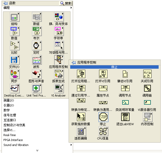

延时肯定是必须要等待完毕的。你可以试试在一个并行的循环里面调用停止的VI。

PS: Below is of Context Help of STOP vi. Try avoid using STOP unless necessary.
Stop Details
If you need to abort execution of all VIs in a hierarchy from the block diagram, you can use this function, but you must use it with caution. Before you call this function with a TRUE input, be sure to complete all final tasks for the VI first, such as closing files, setting save values for devices being controlled, and so on. If you put this function in a subVI, you should make its behavior clear to other users of the VI because this function causes their VI hierarchies to abort execution.
In general, avoid using this function when you have a built-in termination protocol in a VI. For example, I/O operations should be performed in While Loops so that the VI can terminate the loop on an I/O error. Also, consider using a front panel stop button Boolean control to terminate the loop at the request of the user rather than using this function.
