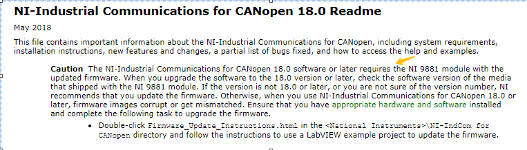

从官网的资料上来看,我有cRIO-9035,但是我手上并没有NI9881,只有一块NI9862,不清楚是否能实现CANopen的通讯功能?
http://www.ni.com/download/ni-industrial-communications-for-canopen-18.0/7435/en/
The following devices are supported for use with this download:
  • NI 9881
  • PCI-8531
  • PXI-8531
  • cRIO-9030
  • cRIO-9031
  • cRIO-9033
  • cRIO-9034
  • cRIO-9035
  • cRIO-9036
  • cRIO-9038
  • cRIO-9039
  • cRIO-9063
  • cRIO-9064
  • cRIO-9065
  • cRIO-9066
  • cRIO-9067

感谢,看来我需要找另外的方法了!

冒昧的打扰一下,那NI9860这个模块能支持吗?

您好,
CANopen 18.0 需要 NI 9881
参考:http://www.ni.com/pdf/manuals/375165f.html
