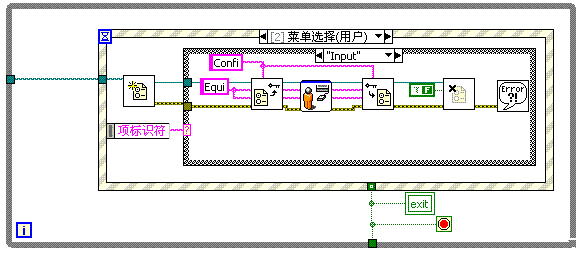

我本来打算使用点击菜单的方式读写ini文件的可是不行,而且第二次再点击该菜单时还会弹出如下错误提示,但是我在外面读写ini而不是在菜单事件里读写是完全可以而没有错误,这是怎么解释?望大家帮我答疑。

Proper "closing" of the config file is necessary, and you should do it once only upon exiting the entire code.
What I mean is that the Config File could be already closed (by the outside Case), when you are trying to access it through the even case(s).

但是他为什么不能读写到ini文件呢?读到的是空值,写也是空。而不加事件的是可以

As already mentioned... the Config File is, probably, already been closed (at the outside Case).

err.JPG那我现在更改成这样但还是不能读到数据,跟保存

When writing a config file, the input "write configuration file? (T)" to the Close Config Data.vi must set to True.
And, set to False for reading.

的确设为TRUE就能把数据保存。已经解决这个问题了,原来是有读到数据的,只是在控件初始化时这个给清空了,所以没看到,我设断点就明白什么问题了。thx ian fung
