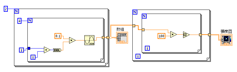

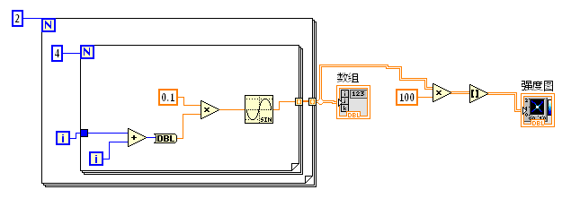

I have builded two similar VI.  just as below.
in this VI, i add two for loops.
in this VI, i remove the two for loops.
after doing these, i run the two VI, and i have got the same result. why ?

The code is functionaly equivalent.  The fundamental mathematical operations (multiply, divide, absolute power, etc) are smart enough to work on arrays as well as scalars.  So your multiply by 100 is done on all elements of your 2D array, the second version is just simpler to read and implement.
