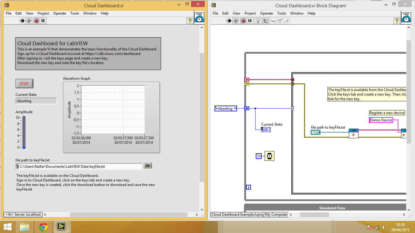

hello
i have a problem when i run the Cloud Dashboard
i think that the project can't read the key file . the current state switch between clearing and aborting.
i'm using labview 2013 sp1
Message 22 of 43
(8,683 Views)

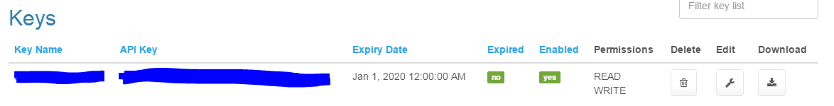

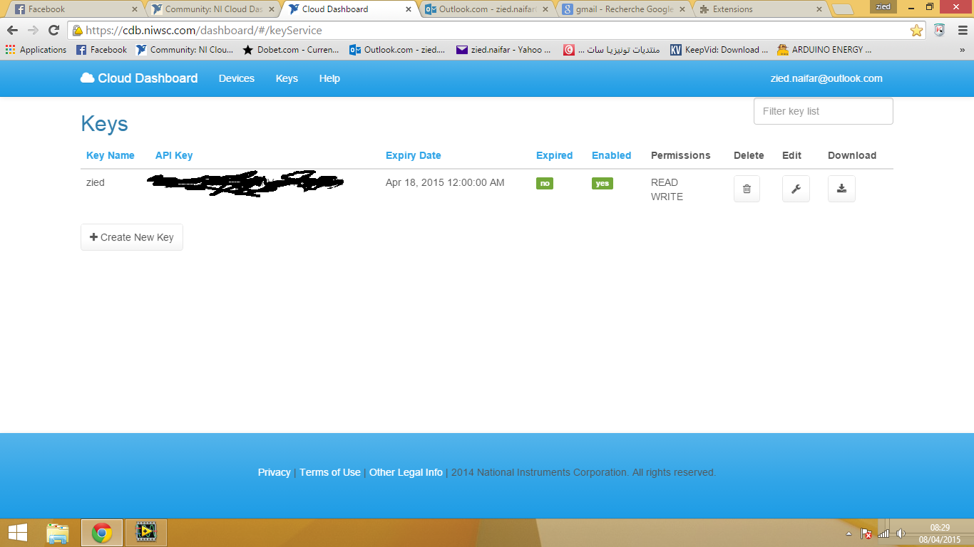

Hi Zied,
I have just ran a test to the CDB a moment ago.
May I know what is the expiry date, the permssions and the enable status of the key you are using ?
If the permissions are read only, I would recommend to have the permissions to allow write too.

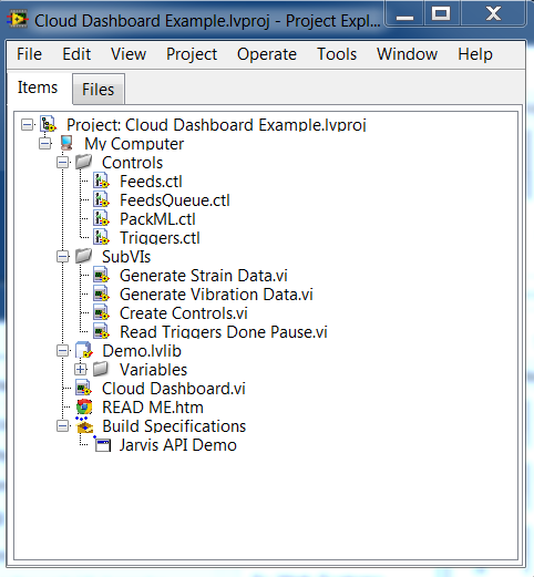

and i have a problem when i try to open the project of Chris Larson  (Cloud Dashboard.zip)
so if you can send me your project
Message 24 of 43
(8,683 Views)
Hi Zied,
May I suggest you to try out the example in the C:\Program Files (x86)\National Instruments\LabVIEW 2013\examples\Cloud Dashboard instead ?
I suspect that the example that you have taken from Chris needs myRIO to work.
You should be able to see similar project if you have loaded the default CDB example bundled with the CDB vip.
