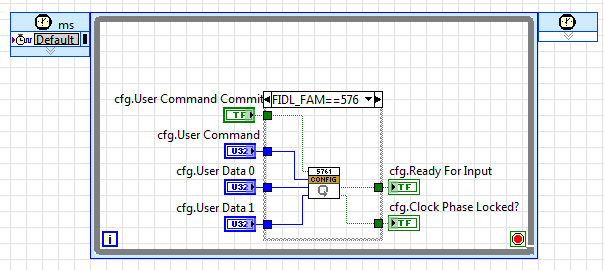

I guess that this loop is config clock FPGA.
I would like to know how correctly create this loop for NI 6585? Is it possible?

I hate to answer with a "that depends," but... that depends on how you are clocking your logic.  In the digital adapter modules for FlexRIO, there isn't a clocking chip on the adapter.  You use the clock in the diagram by creating a clock of the appropriate speed in the project and running your single cycle timed loop on that clock.  You can also bring a clock in on a clock capable pin (see the documentation for the digital adapter modules).  For static configuration of clocks, this is all that is required, and using the clock config VI isn't necessary.
In principle, you should be able to create logic in the CLIP and your own clock config VI to actually mock this interface to allow you to switch clocks at run time.  If you have loops that need to be reconfigured at run time, this would be a reasonable starting place, but you will have to do VHDL work in a custom CLIP to make that happen.
