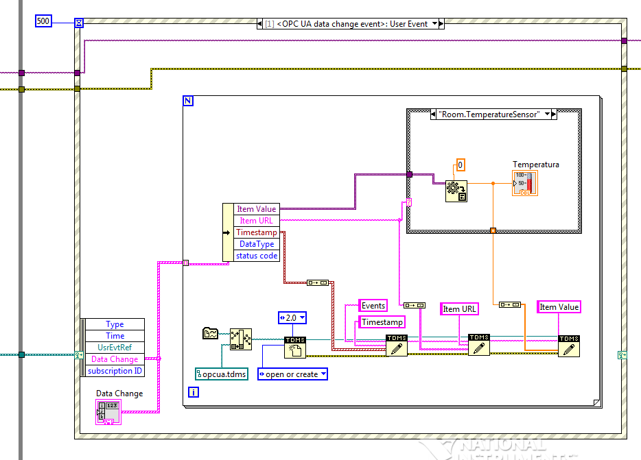

I have some trouble with OPC UA client. I have one variable at the server which is incremented every 100 ms, and I made subscription to it.
I set update rate input in create subscription vi to 3000 ms. In this case, with every notification I should receive more or less 30 data change events. I set also queue size of monitored items to 500 (much more than I need, just to be sure)
In vi I write all notifications to tdms file, but unfortunately, when I look into the file after my test, I see only one data change event every 3 s. It seems that client reads only last data change and doesn’t retrieve the rest of them. I'm using LabVIEW 2015 with DSC Module and I run the vi in development environment
Where I made mistake?

Hi Thomas,
Have you tried to specify the "queue size" other than the default value "1" in the termnal "notification queue settings" of NI OPC UA Client.lvlib:Add Monitored Nodes.vi? The default queue size is "1" so you only get 1 value returned for each notification.
Yan

Hi Thomas,
I'm not using LabVIEW anymore since a few years but I saw your message, and perhaps I can give a clue from a purely OPC UA point-of-view.
OPC UA has two interval settings to configure, to do what you want:
  1. the publishing interval on the SUBSCRIPTION: how frequently do you want to receive an event (set to 3 seconds in your case)
  2. the sampling interval on the MONITORED ITEM itself: how frequently does the server has to sample your variable (set to something lower than 100 ms in your case, e.g. 50 ms)
Perhaps you forgot the second setting, as you didn't mention this? I think if the sampling interval is 0, the server must sample at maximum speed, though I'd need to look that up. But beware, there may be a minimum sampling interval set by the server, so the server may "revise" your requested sampling interval. When the client creates the monitored item, the server responds by sending the "revised sampling time" to the client.
Besides that, also (as you say) set the queue size to a value > 30, and you may also want to set the "discard oldest" setting to True in case the buffer would overflow (which cannot happen in theory of course, since your buffer > publishing interval / sampling interval).

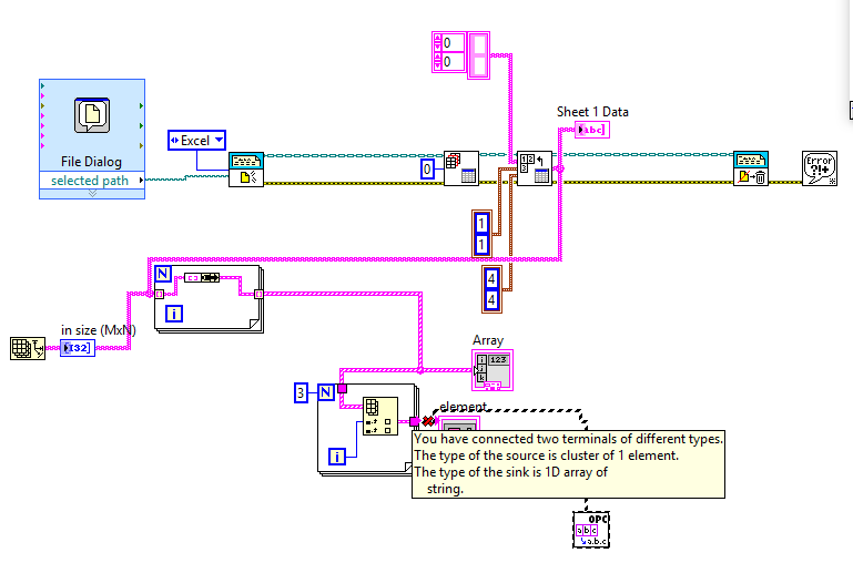

I am new here, also new with using OPC UA with Labview. I hope I can get some tips and help on some issues. I am sorry if its nt the suitable place to post here But I need to start somewhere:D..
As I said I am new to OPC UA Labview. I am reading about its capabilities but I am not sure if can do what I am thinking of. I have two questions.
1) Is there any time difference between calculations done in the OPC UA server and the information to be displayed at the OPC UA client? Can we use the timestamp to display the timing for each reading? and is there any data loss if there is a time difference?
2) If we had all data for Folders/Items/Properties arranged in an excel sheet or any kind of file, is it possible to read from that file through OPC UA and generate internally in some kind of array or any other way the whole structure of all folders and items? instead of placing the folder/item/properties Palletes manually for each folder and item in the list?
Elias

Hello Carlos,
Thank you for your reply.
So far i was able to exctract data as cluster of array of strings. I know there is an OPC UA vi that tranform node name array to node path but I am not able to reach a compatible data type input for it. I am stuck there. And I want to know if that VI can be used in a loop to enter the data and save the node paths generated. For example, I want my program to read information of 20 folders from the excel sheet and creat a data structure for them as listed in the excel. And do you have any tip for entering the node attributes also dynamically from the excel sheet or at least how to integrate it in parallel while creating the folders/items/properties. This is a screenshot for my code, I didnt find the option to upload the VI file.
Any help would be highly appreciated.
Thank you
