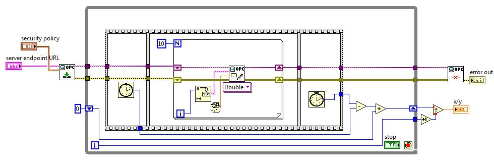

I'm having some problems with OPC UA Write function. I'm writing 10 tags to a Kepware OPC server in a 1 second cycle. The time spend writing each tag is varying from 15 to 30 ms, the whole operation reach 500ms sometimes. This is limiting the number of tags that I can use in my application and turning the control output time unpredictable.
It seems that the problem is related with the write operation but not data size. If I do a consolidated array write of many tags at once doesn't change the time spent in the single operation. I'm actually doing this to get some time relief.
Parallel to this I have a async reading loop accessing hundreds of tags without problem.
Is this a normal behavior? Is there any way to write data asynchronously through OPC UA API?
The code is running in a cRIO-9022.
Message 108 of 150
(2,504 Views)
I think if you need to get the error out of the write vi, there is no async way of writing.
I tested this with the UA APIs and found that the operation of writing 10 tags always take about 5ms. Maybe your issue is due to the Kepware OPC Server. You can try another UA Server.

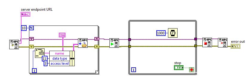

Hi!
I'm trying to benchmark the opcua server on a cRIO.
To do this, I increase the number of nodes managed by the server (LVRT/cRIO) and the number of monitored nodes by a client (LV/host).
-> The population of the server is fine; I can browse all the folders/nodes I have created.
-> The subscription and "add monitored nodes" seem to be fine: the size of the status returned by the "add monitored nodes" VI equals the size of the array of node paths.
-> But when I get an "OPCUA Data Change Event", the size of the Data Change Array is limited to 20.
Is that a normal behavior?
