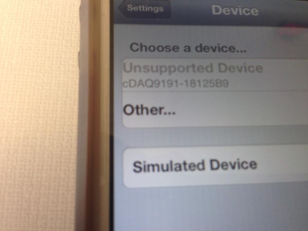

I ran into a problem when I tried to use IPhone to display the data from cDAQ-9191 with a NI 9215 modulus. I downloaded the NI cDAQ-9191 App from Apple store. I updated the firmware to the special version 1.2.10f2 according to the instructions from the forum. I set up an ad-havoc network using the 9191 chassis. My Iphone could detect and connect to the device. However, In the device setting of the APP, it showed "Unsupported device (cDAQ-9191 serial No.).   I clicked the device. The error message was invalid firmware. Did anybody run into the same problem? What should I do to solve the problem? Any advices are highly appreciated.

Does the web API return the system state correctly?
In Safari, go to your device's IP address with this URL:
192.168.x.x/daqwebapi/1.0/system
When I do this, I see:

Thank you very much for your advice. Here is what I got:

The only difference is that I used a NI 9215 with screw terminals. In your case, you used NI 9215 (BNC). Also, I used an ad-hoc connection instead of using a router. Wonder if these differences caused the problem? Another thought is whether the IPhone APP can work with IOS 8 or not. Thanks again.

Since the system service used "cDAQ1Mod1" for "Chassis.ModuleDevNames", it means that the module is supported. If it were a different module (like a 9201), you would see "cDAQ1UnsupportedModule1" instead.
I can also use an ad-hoc connection with the application.
The app does work with iOS 8 -- I use it with iOS 8.2 on an iPad Air. The UI still uses the older iOS 6 look and feel, as you can tell. It hasn't been updated for the iOS 7 visual design language.
The next step is to look for more error details. Once you receive the error message about invalid firmware, use the same /daqwebapi/1.0/system API and inspect it for differences. If you can, tap the "Play" button to configure a measurement and run it once, and then inspect the /daqwebapi/1.0/system API output again. When I do this, I see:

Thanks you very much for your reply.  The problem happened when I tried to set up the device in the APP. Therefore, I couldn't run the APP using the device. My IPhone can detect the device automatically. The following image is how it looks like in the Settings page of the APP.When I clicked it, the error message popped up as "Device Error   Invalid chassis firmware. Upgrade chassis firmware".  Then, I went to the system page and got the same API output as shown in my last post. By the way, because I used the ad-hoc connection. I couldn't use my IPHone to check the API output. I used my laptop by connecting the cDAQ 9191 to the network with a Ethernet cable.
Have you tried using IPhone for ad-hoc connection?  I tried a different IPhone also running IOS 8. That IPhone couldn't even connect to the device.
