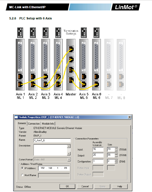

I have a project I am controlling three LinMot linear rotary motors (PR01 84x240F-C-100).  Each motor requires two drives( B1150-ML-IP), one for the linear axis and one for the rotary axis.  So in all I have six servo drives connected to one control bus module (B8050-ML-IP) that I am communicating with through Ethernet IP.  The bus module is capable of controlling up to eight drives, however I am only using six.  When I am using the Ethernet IP vi's Get Attribute and Set Attribute I get an error when using the instances (16 read & 26 write) LinMot shows to use in their user manual (see the attached Page 20/24).  The manual says I am supposed to be reading 26 bytes and writing 32 bytes per drive, for a total of 156 bytes and 192 bytes respectively for 6 drives.  When I run I am only reading 18 bytes when I should be reading 156 bytes, 26 bytes for each drive.  Also when I attempt to write (instance 26) I get the error as stated earlier (see attached).  I am wondering why I can only read 18 bytes and why I get the error when writing.  Also I am using class four attribute three.   http://www.linmot.com/fileadmin/doc/Manuals/E1100/Usermanual_MC_Link_with_Ethernet_IP_SG5_e_recent.p...LinMot_6axis_params.pngEthernet IP error.jpg
