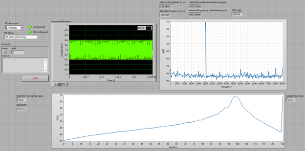

Using the VI NI 5772 (AC) – TIS Mode Setup & Calibrate (Host).vi, the ADC is put through an on-demand calibration cycle and the DES Timing Values (the timing adjustment between rising and falling sample clock edges of the interleaving ADC cores) are iterated through to find the best SFDR.
In this picture, we used an input tone of 1350MHz @ -1dBFS (w/2x 1350MHz LPFs on front-end to remove generator harmonics) to demonstrate the 2nd Nyquist operation in which we saw sub-specification SFDR. Once the best DES Timing Value is found, the value is applied and written to the on-FAM EEPROM (arbitrarily at address 0xF0 in this example).

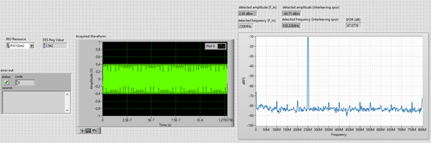

From here, the test VI NI 5772 (AC) – TIS Mode Acquire (Host).vi is used to read from the EEPROM, apply the DES timing values and demonstrate the much better resulting SFDR (here measuring @ 67.1 dBc).

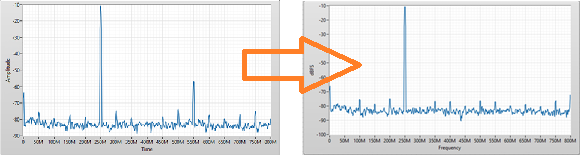

As well, since the routine is finding the best timing values for the interleaving cores, the SFDR is improved across input frequencies.
