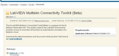

Maybe someone could change the requirements mentioned on community website (look at today's screenshot). I tried to use the Multisim Toolkit with LabView 8.6.1 and Multisim Full Edition 10.1 (!). Guess what, I got the same Error again and again - until I came here to read the articles in this board, where you can get the information that PowerPro Edition is needed.
Message 38 of 43
(11,798 Views)
Thanks for the message. I just edited the community website to reflect those changes.
