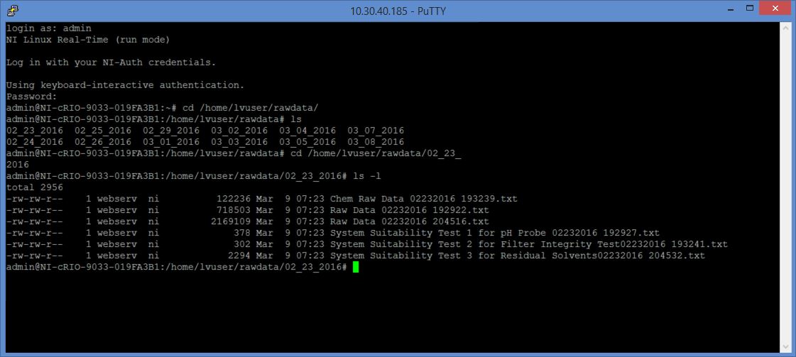

We might be on to something here,
Before formatting I looked at the files and they had the permissions of "-rw-------"
I have reformatted and reloaded all files from the archive and now the permissions are "-rw-rw-r--".
Is there some care that needs to be taken in Linux to retain this permission?
Post format and newly loaded raw data...

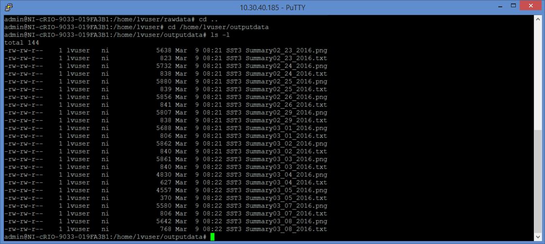

I ran the code post format and all newly deployed data files and the code runs as expected. The output files look like this...
I will watch the file permissions, but would I have to run a System Exec with the "chmod" command to set the permissions? I am not sure how to use standard LabVIEW file I/O VIs any differently to ensure proper permissions?!?!?! How would these change over multiple use and handling of files?
