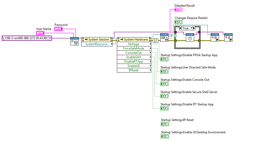

Here is a simple example on how to use NI System Configuration API to change Startup Settings of a remote Real-Time controller.

your example is clear. Thank you.
my error code is -2147220623.
i have this error only if i connect wires of IP reset and UI Destop Environment.
if i call function but i don't connect those wires, it is ok.
Is it normal?
Message 9 of 17
(5,653 Views)
