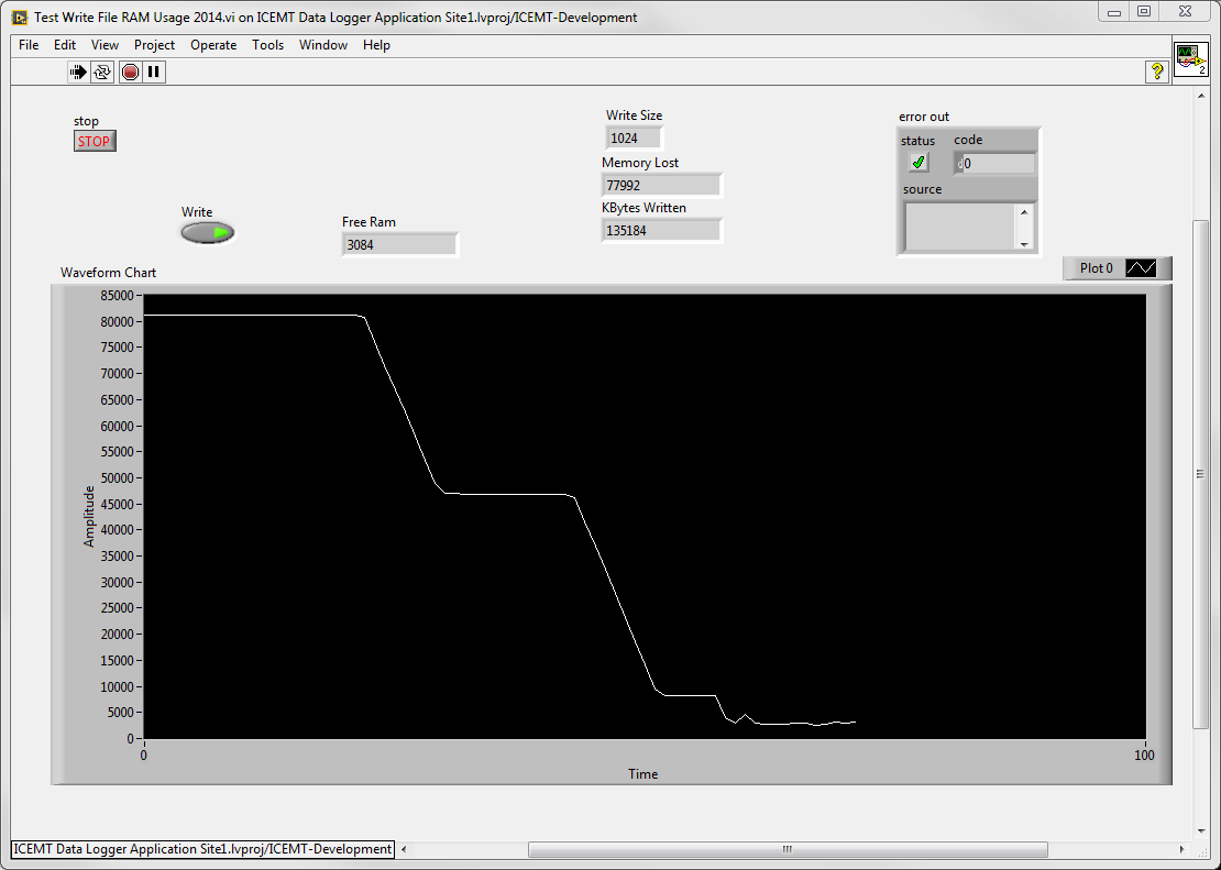

I would expect the amount of RAM the OS uses to go up and down (but assume it would be broadly flat over time). I think ther is a more fundamental error in the way the memory is reported using this property. It seems to have been fixed in the distributed system manager, as that reports stable memory usage when writing to files.

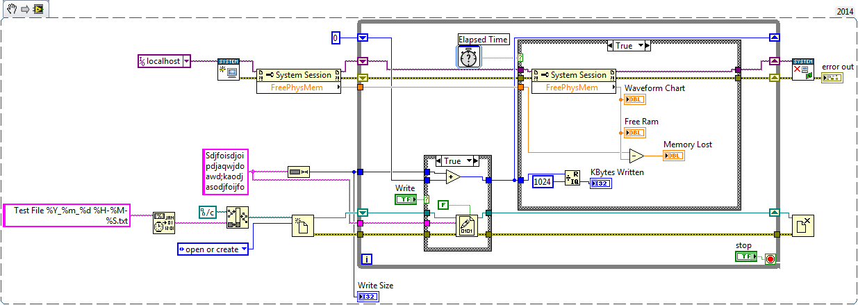

The attatched image is what I get when writting files and reading the FreePhysicalMemory property. Where the graph is flat is where I have disabled file writting. It then bottoms out at around 3MB. Memory is only recovered when the files are deleted. DSM reports available memory usage as flat while this VI is running.
Here is the code I used for this test.

I would be happy if it just reported the same as the DSM.

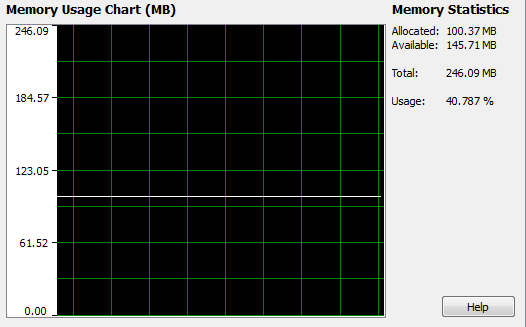

As you noted, DSM works around this by reporting not "free physical memory" but "available memory". As I mentioned in my reply to BlueCheese above when he suggested that name, it's a pretty vague name when there are so many possible meanings for "available" with respect to the OS.
It sounds like you would ideally like the current property to be renamed to "available memory" and report the same metric that DSM reports. That "available memory" stat is the result of some not-exactly-self-explanatory math, along the lines of (CommitLimit * 97% - VmSize * 3%) - Committed_AS. The Linux memory manager does not allow non-root processes to use the last 3% of the commit limit, and does not allow a single process to grow too big, requiring it to leave 3% of its size for other processes. All this is also ignoring the complexities of overcommit, which is probably beyond the scope of a short post here but you can read about at https://www.kernel.org/doc/Documentation/vm/overcommit-accounting for details. It also doesn't help that the VmSize * 3% depends on which process you're asking about, and there are many processes possibly of interest in the general case. You can probably imagine why I'm a little reluctant to boil all that down to "available memory", let alone simply replace "free physical memory" with that.
Changing it to report the LV process memory usage would mean it is difficult to know when the program will run out of memory as you don't know how much the OS is using (we often reboot the application if available memory drops beloow a certain value).
That's true and is a valid concern. That's why I wanted to double-check that your question was mostly about leak checking. If you're worried about the entire OS running out of memory (independently of leaks in your LV application) that is yet a different metric.
Is this an accurate summary of your position: the "available memory" heuristic we use in DSM is pretty useful for both leak checking your application and confirming the OS isn't running low on memory. It's not an exact science and that metric technically isn't telling you either of those things to a high degree of accuracy, but it's giving you the basic idea and that's what you're looking for. You'd like it if the existing "free physical memory" stat would report that "available memory" stat instead on Linux. You're not picky about the name or the implementation details as long as the same property can used for application leak checking and OS low memory conditions on all three OS's.
