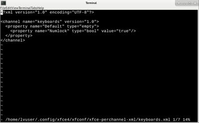

Embedded UI uses Xfce, so the methods for enabling numlock on that Desktop Environment should work on cRIO Embedded UI devices. There's a ton of documentation about this online so I recommend reading up if you're interested in learning more about Xfce and the options for it.
A quick search shows that what you ask can be done by editing the keyboards.xml file for the Embedded UI user (lvuser). This file can be found at /home/lvuser/.config/xfce4/xfconf/xfce-perchannel-xml/keyboards.xml. In that file, you'll need to change the "Numlock" property value to "true," save the file, and then reboot the system.Numlock.png

Thank you for your help. This is worked for me.
