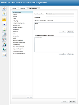

Most of the things you're asking about have permissions defined within the cRIO Web Configuration Interface. There are linked sets of accounts: the actual Linux user accounts and the ones used for NI Authentication. The latter is defined through the Web Configuration. While there are default permissions, these may be configurable depending on your needs and the users you have created. Note that this interface allows the creation of users and assigning permissions for the NI Authentication that many of these items use. Permission.png
To address defaults for some of the specific ones you call out:
  • Firmware updates are admin or administrator group only but can be configured as described.
  • Software Installation requires administrator privilege. I'm not sure if there's any way to change this one.
  • RAD is tricky as it does a lot of different things and some of these require different permissions. That being said, I believe the default is to require admin since the underlying System Configuration API call to get an image requires those permissions.
