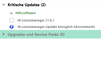

  • But NIPM does not list this as a potential update and only lists eight non-driver updates:
  • I have tried the NI Update service as well, but this one only lists the last update seen in NIPM (licence manager), nothing else.

Hi Christian, the Updates tab lists patches that are released against existing feeds that were used on this system previously to install software, and the feed is still registered in NIPM. New quarterly versions of software are what NI considers major releases and those exist in new separate feeds and must be installed either using the Browse Product tab in NI Package Manager or initiated using a download from ni.com. NI Update Service only lists patches on the Updates tab that NI listed as critical when published, and this does not happen very often. I am not aware of any public or automated list of all driver releases.
