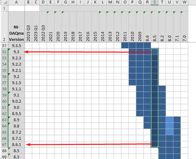

No, the latest DAQmx is not compatible with LV 8.5. Please check the following link for compatibility.
https://www.ni.com/en/support/documentation/compatibility/16/ni-daqmx-and-labview-compatibility.html
For LV8.5, DAQmx 8.6.1 to 9.3 is supported.

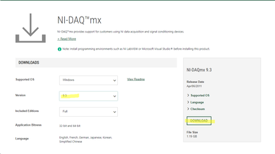

Thank you for your reply. Now I need to know how to install an earlier version of DAQmx into the LabVIEW 8.5 IDE. On this page I see options for earlier versions:
https://www.ni.com/en/support/downloads/drivers/download.ni-daq-mx.html#521556
Would an installer from there include installing the DAQmx VI palate into LabVIEW 8.5? If not how is this done?
(2,092 Views)
Yes, select the supported versions and download.

I have DAQmx working now. Your chart shows the latest DAQmx version that should work in LabVIEW 8.5 is 9.3. But 9.3 did not work. Version 9.0 did.
