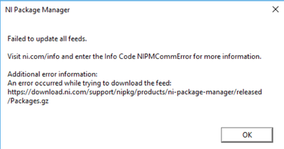

Some additional info... the timeout is closer to 15-20 minutes, and at the end of the wait I get the following pop-up
The code seems to cover all use cases except for extended timeouts because of LAN vs WAN access....

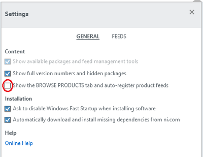

As a workaround, you can do the following:
1. Open an admin command prompt to %ProgramFiles%\National Instruments\NI Package Manager
2. Run "nipkg remove ni-package-manager-released-feed --force-essential"
3. In the NIPM settings window, untick the setting for showing the "BROWSE PRODUCTS" tab. You can get to the settings window by clicking the little gear icon in the upper-right corner of the NIPM main window.
