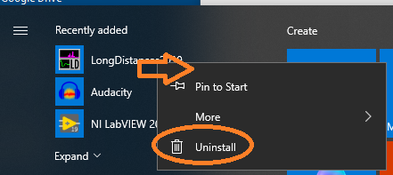

  5. OK, so how do I uninstall this thing now???? Tried:
    1. Windows 10 start menu, right-click app icon...uninstall. Just opens windows control panel and new install is nowhere to be seen.
    2. Open package manager ... all I see is the old 2015 version. Nothing about the new 2019 version.
    3. double-click package again: Message: "Package is already installed, No operation will be performed"
    4. Again: How do I uninstall thins thing!!!????

I guess my problem is related to my first post (Not following any instructions (point 5 :D), but following typical procedures).
Let's assume they don't have any existing NI software and want to uninstall whatever they put on minutes earlier because they don't like me or my programs.
The start menu has an "uninstall" right-click item added by windows 10, so most might start there. Clicking this opens the software control panel and my app is nowhere to be seen and nothing happens. They might think that NIPM relates to it and uninstall that instead (Yes, there will be warnings, but if they ignore them, my software will probably be stuck there forever. ;D!)
Maybe this is something that could be better implemented in windows 10 such that if I click "uninstall", NIPM would open instead. Not sure if that's even possible.
