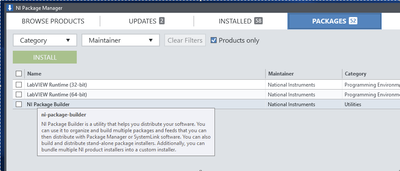

I will add that I can't find anywhere "Description" from a LabVIEW build spec's package attributes is displayed. Where does this info show up in NIPM?:

Hi SteenSchmidt,
Currently the package description is displayed in a tooltip when you hover over the package. For example:
Thanks.
