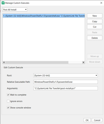

I'm trying to build a NI Package with a custom Post Install script. Ideally, I would want the Post Install script to run a Powershell command or a Powershell script.
I'm spending way too much playing around with the custom execute. This syntax makes no sense to me whatsoever.  Can someone post an example of how I would run a Powershell script in the example folder C:\SystemLink File Transfer? See below for what I have right now.

Not sure if that is the case but I had similar issue with running any post action and gave up eventually:
https://forums.ni.com/t5/NI-Package-Manager-NIPM/Error-125440-An-error-occurred-while-running-the-cu...
