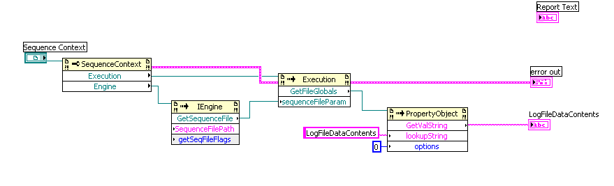

I'm interested in doing the same so I'm asking for some clarification. I created a VI which runs in a sequence called by the process model. I've attached an image. I'm new to TS but can work well with LV that's why I'm using LV for this.
The Global is called:LogFileDataContents. My question is what do I pass for "SequenceFilepath"? I was thinking to use: "RunState.ProcessModelClient".
I guess the real question is: is this the best way to pass data from the test sequence to the process model? What is the recommended method?

Hi Test_Stand_Newbie ,
Why dont you just set the client sequencefile properties to use a common fileglobals. By default each sequencefile is set to use seperate fileglobals.
The Engine.GetSequenceFile wont work because you are opening a new reference to a sequencefile, when in fact when your sequencefile is executing, your process model is all ready loaded.
Where is this sequence, is in the processmodel sequencefile or the client sequencefile?
Yes, after looking at the docs, I came to the same conclusion.
The sequence is called from the processmodel sequencefile. I am trying to access the globals in the client sequencefile.

The Process Model sequencefile has the same properties as the client file, so I thought it might also apply. But it doesn't, my mistake.
So, its as James outlined using the method :
Execution.GetFileGlobals(RunState.ProcessModelClient) which will return a PropertyObject reference.
You would use this reference with the PropertyObject methods and Properties,  to do what you need to do with the fileGlobals of the client file.
