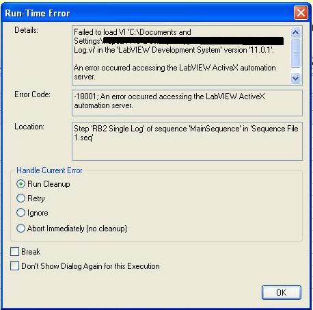

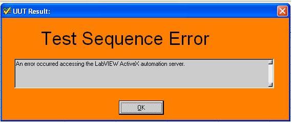

Pretty much since the start of this project I've been getting some errors regarding ActiveX. I have been ignoring them until now since I was unable to fix them. Some of the errors show up if a sequence fail. I might get a list of unreleased threads that start something like this
 References to PropertyObjects were not released properly.
              Total number of objects: 38811
              Number of top-level objects: 258
I'm not so much worried about this error. I think it's just a consequence of me forcing the program to kill all the treads. What causes the program to crash is a bit more worrying though.
I've had a discussion earlier regarding the dll's I'm using in my program. An explanation of what's going on in the sequence and some opinions about it can be found in this thread.
Here are some of the errors I'm getting:
Any input on what's going on and how to fix this would be greatly appreciated!

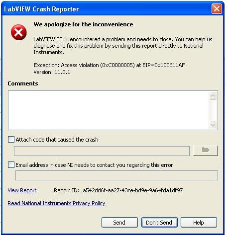

The unreleased objects happen when I kill threads. The ActiveX and 18001 related errors, the errors I have screen shots from, happen randomly when TestStand tries to run one of the VIs in my sequence. It seems to happen once every hour or two when my sequence is running.

Getting leaks when killing threads is definitely an expected possibility.
The other errors you are gettings are likely caused by something the VIs are doing, especially the access violation. The mostly likely cause of crashes like that are when calling into dlls or passing structs to dlls with the wrong prototype. Such calls can lead to random crashes and memory corruption. Ideally, if you can narrow down the VIs which must be called in order for the problems to occur, you can then look at those VIs more carefully to see if there are any problems with what they are doing. If it really is a memory corruption issue, then the location of the crash doesn't necessarily indicate the location of the error. But if you notice it always crashing at around the same place that might give you a clue. If there are changes you can make to the sequence that makes it happen more or less often, that could also give you a clue as to the VIs involved.

In order to investigate the root cause of this issue, we'd like to take a look at the LabVIEW crash information.  Please attach the latest crash information file to this thread.  The file can be accessed from the LabVIEW crash dialog by clicking the "View Report" Link.

It sounds like you're seeing the same thing I'm seeing.  The sequence is running normally and then LabVIEW will crash at a random location.  Once the crash occurs, you see the TestStand dialog with the ActiveX Automation server error message, but the cause of that is the LabVIEW crash.
