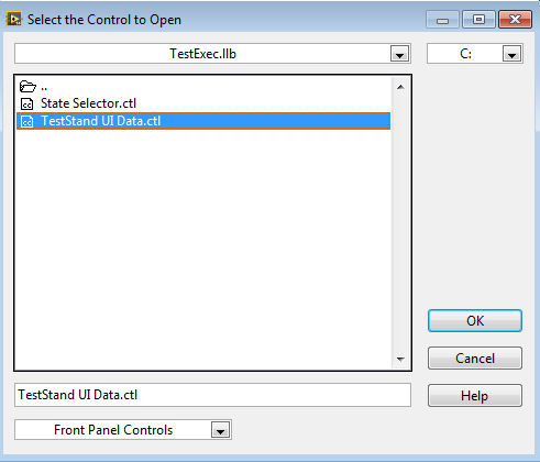

Hello hlim,
to fix this, replace the control with control inside the LLB
Hope it helps

Hello Alexander Glasner,
Thank you very much for the pointer, it works. I wonder why the error in the first place though.
I am learning something new about TS/LV everyday!
