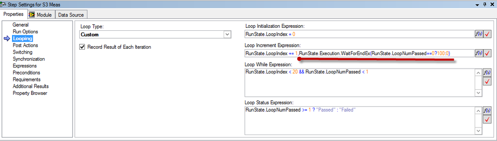

I was originally trying to get a delay in the loop, everything in 1 step
jeff

I used a custom loop to add a delay if the step failed until I got a pass to continue
Add this code to the "Loop Increment Expression"
RunState.Execution.WaitForEndEx(RunState.LoopNumPassed==0?100:0)

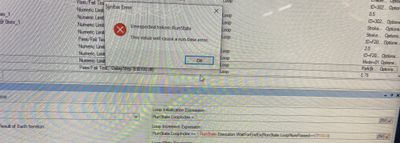

Could you help me? I don’t know why when i try to use your Loop Increment Expression, it appears that syntax error.
thanks!
