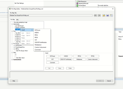

We are using Teststand / TSM version 2014 and planning to use Digital Pattern instrument for the same. We are working on developing production test solution on NI PXIe system for one of our customer.
We are creating pin map and trying to add Digital Pattern Instrument { 6570 } and we don’t see option in it { see below snapshot }, but we are able to view our 6570 in Digital Pattern.
Can you please let us know how we can add Digital Pattern instrument in TSM PinMap and also please do send us some e.g Programs using same.

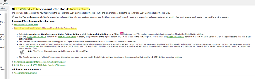

TSM2014 is way too old, I would recommend upgrading to the latest (at least TSM 2019 or better TSM 2020).
Digital Pattern support was added starting TSM 2016 and hence not available under 2014.

If you cannot upgrade to the latest TSM version and have to stay with TSM 2014, the only option would be to add the 6570 as a custom instrument and handle all the necessary actions inside your code modules.
