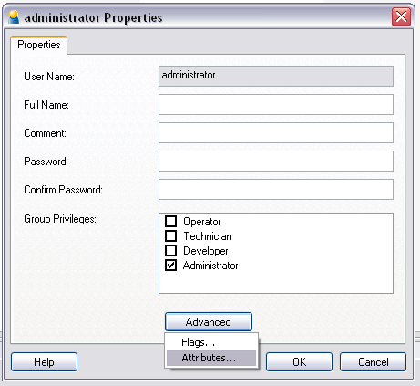

Another thought- you could use the Attributes of PropertyObject to store data about a user
(In Teststand 4.2.1):
You can do View > User Manager, then look at the Properties for a user
Where you may see the option to add an attribute.
(3,823 Views)

Thanks for your replies. I looked up the administrator properties, but clicking the Advanced button went straight into flag settings - I guess TS 3.1 doesn't have the option of attributes. I've tried a few more things and found I can read the 'GetType' property in Labview for the new field I'm trying to create, but not much else. I thought of trying to read the comment fields for each of the users, but had no luck with this either.

Attributes were introduced in TS 4.2
