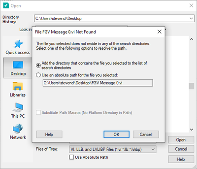

I found the ConfigEngine privilege and noticed that this turned off many configuration options in Station Options and editing Search Directories.  I was especially interested in preventing my end users from messing with the Search Directories list.  However, I've noticed that when they're developing a TestStand sequence, they can still add Action steps to code modules at any path they want and the dialog when selecting vi's allows you to add new search directories. I thought it would prevent them from actually adding search directories, but it seems that they are able to. This strikes me as a bug. Am I missing something?  Is there any way to actually prevent end users from modifying the SearchDirectories list without fully removing all sequence editing privileges?

I wouldn't call it a bug, rather a "legacy behaviour" which is not neccessarily state of the art.
SearchDirectories.cfg is just a text file, which is located in a publically available folder. So it is modifiable by design.
In fact, the NI TestStand Exercises / Solutons that come with the official training leverage this behaviour for creating backups / using solutions for exercises.
And I am pretty sure, that there are usecases, where people use this feature.
Looking through the security lens, this behaviour is critical, since a change of search directories could be used to use potentially malicious code.
