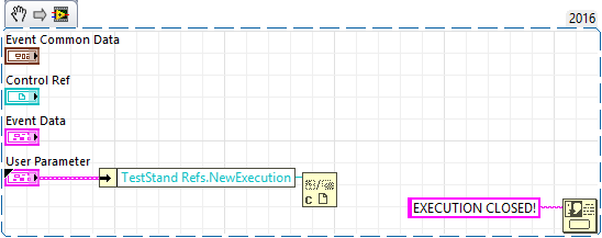

I have a callback assigned to "EndExecution" that is running the following code:
The "Execution Closed" message is simply there so I know when it is running. I expect this callback to run when the execution of the current sequence finishes. However it seems to be running after a user has been logged in. I have triple checked and i'm registering the above code to run under these conditions:
Is there something I am not understanding? I use callbacks for user login/logout and they execute correctly

The reason it comes up after the user logs in is because of the Front End Callback execution ending.
If you unbundle the event data you should be able to see what the execution ID is.  You can compare that against the execution id of your NewExecution and only close it if they match.  Otherwise do nothing.
Just a thought.

Thank you, I misunderstood "EndExecution" to mean end of the sequence execution, not any execution.
