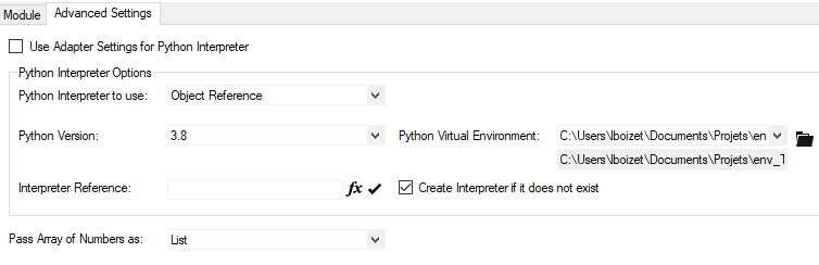

Do the following for the workaround:
- For edit substep, in the step settings dialog, launch advanced settings dialog.
- Disable 'Use Adapter Settings'.
- In the advanced settings, specify the version of Python to use for edit substep.
- Set 'Python Interpreter to Use' to be 'Object Reference'. Ensure that 'Interpreter Reference' expression is empty and 'Create Interpreter if it does not exist' enabled.
- Click OK and save the details.
Now, everytime you click the edit button, edit substep will execute in a new interpreter session.
The only disadvantage is that, there will no longer be one location to modify the Python version. In future, if you need to modify the version, you need to do it in both adapter settings and in the advanced settings of the edit substep.

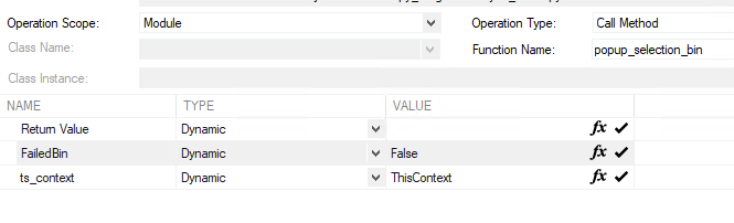

and the call from the Edit substep of the step type
As the popup message is not displayed when I click on the edit menu, I guess the popup_selection_bin is not executed.
I tried your workaround but I have the same error message at edit time

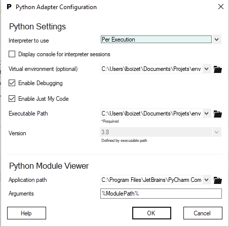

Below is my configuration of the Python adapter
As I said previously, the error occur only if I display a python popup window at runtime
Regards
