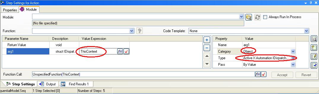

Can I pass the sequence context to CVI without the tTestData structure
I found the following in the code template directory:
void __declspec(dllexport) __stdcall @REPLACE[FunctionName](CAObjHandle seqContextCVI,
        char reportText[1024], short *errorOccurred, long *errorCode, char errorMsg[1024])
It has CAObjHandle instead of tTestData. This is nice except I don't know how to set the CAObjHandle parameter from teststand. How can I access and pass this parameter in from teststand?

Hey Steve,
The TestStand API for CVI, which can be found at <TestStand>/API/CVI/tsapicvi.fp, uses this CAObjHandle to communicate with TestStand.  In TestStand, you can specify to pass a CAObjHandle by selecting the parameter to be an “Object” for Category and “CVI Active X Automation Handle” for type.  See the screen shot below.  Once CAObjHandle is selected as the parameter type, you can pass any object through this handle.  I hope this helps.
