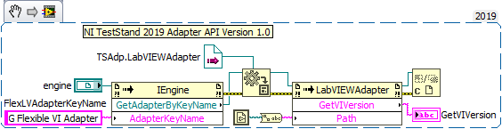

I attached some example VI and sequence file. Lets say I want to write PropertyObject value into the error input cluster (see VI).
I was thinking that LabVIEW Adapter may have such feature, since when I configure LV code module call, TS automatically links containers with LV clusters (as well other types). I was able to call adapter in LV but I don't see any method I could use...

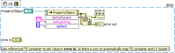

This VI better demonstrates what I would like to have.

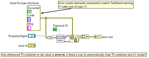

You may need some recursive implementation. I didn't resist to try to get it by myself (easy to say it may be possible like this...). So here is an implementation (I didn't handle arrays, but it should be quite easy to add). I attach the source code, saved for LV2015, there is two sub-VIs in a VI (you will need OpenG support).
Here is what does look the VI.vi code module diagram:
I merged the errors in order to ease bebug of the sequence (not so easy to get it work).
