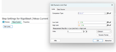

I have created a Custom .ini file and made a step for a limit using  CommandSubStep.dll. After making it, when I use it in the Sequence, I get this type of presentation, as you can see in the figure. i want to make it normal, without popping up a new window, I can change it from the Step setting
If you have any solution please let me know.

I think this KB will answer your question up to TS 2024. Since TS 2025 is using .NET (not Framework anymore), I doubt that this will work in the very same way with newer TS, but not sure.
https://www.ni.com/en/support/documentation/supplemental/18/creating-custom-step-type-edit-tabs-in-t...
