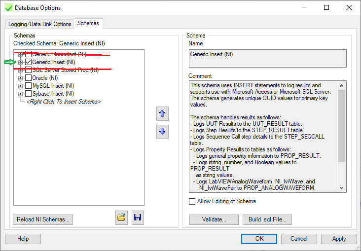

I remade the database with the remaining schema 'Generic Insert (NI)' and it started logging waveforms.
I do not know why neither 'Generic Recordset (NI)' nor 'SQL Server Stored Proc (NI)' worked with waveforms. Their comments specifically mention supporting Microsoft SQL Server and that they "Logs LabVIEWDigitalWaveform to PROP_DIGITALWAVEFORM."
