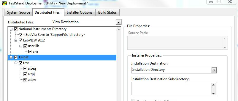

"Target" refers to the top level directory location where the files will be copied when your deployment is created.
In case of the installer, it refers to the location your files will be placed in when the installer is run. You can choose this location in the Installer Properties -> Installation Destination field. If you choose "Installation Directory", it can be specified further using "Default Installation Base Directory" and "Default Installation Subdirectory" on the Installer Options Tab. You can choose different files to go to different target locations.
In this example, a.vi is going to the LabVIEW user.lib directory in the target machine and the other files will be under a folder called "test" in the Installation directory. The exact destination (TestStand Directory, Desktop, Program Files directory etc) will be determined by the settings on the Installer options tab.
Since the Destination Files view never shows the absolute destination path, am guessing D:\Build is your source path (?).
Lastly (whew Smiley Wink), i suggest changing the destination of files directed to <National Instruments Directory> to <Installation Directory> or where ever your other files are going. This way you needn't add any search paths.
If you still want the installer to place your VI in the LabVIEW user.lib directory in the target machine, then you will have to add the LV user.lib path to your TestStand search directories in the target.
