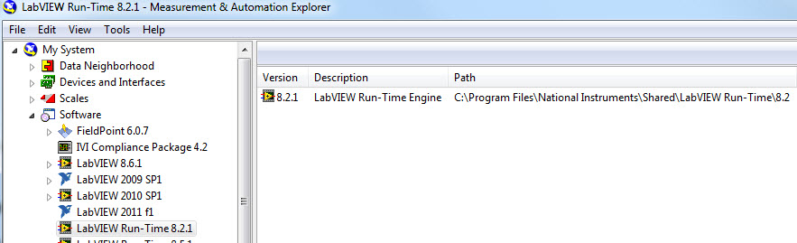

If the problem occurs when trying to open the deployment utilty, then make sure that the path (as displayed below in MAX) is added to your search directories under Configure » Search Directories...

The error is occurring when trying to launch the deployment utility.  I added the LabView Run-Time Engine (8.6) path to the TestStand search directories, but I still get the same error message.
