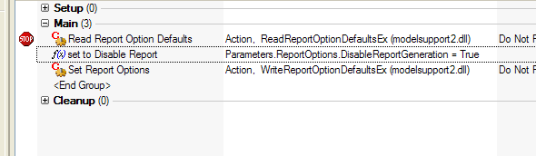

Looking at changing the DisableReportGeneration boolean in the Report Options.
You could use the PropertyObject.ReadEx method to load the configuration data into memory, change the Disable ReportGeneration to True then call the PropertyObject.Write method to save the changed value. (see attached picture - this I have done in a Sequence by calling the ReadReportOptionsDefaultEx() in modelsupport2.dll and then calling WriteReportOptionsDefaultEx(). I copied the first step from Get Report Options sequence found in the ProcessModel sequence file "SequentialModel.seq")
I believe you want to do this in your UI. Therefore your would need to call the relavant API calls that are performed in the  DLL. Have a look at report.c. I'll let you convert to C#
