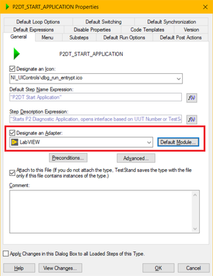

Does specifying default module for a custom step tightly binds the VI path in Steps.TS.SData?
I have a scenario where the existing custom step with default module configured and needs an update.
There were old test sequences which used this custom steps.
However, when I updated the path of this custom step under default module, I get the error in old test sequences that Step.TS.SData.ViCall.VIPath refers to old path and hence the file not found.

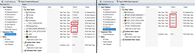

I have also updated the old sequence with latest INI file and latest custom step version, which I can confirm in the Types window.

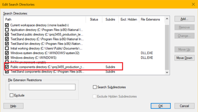

What selections are checked under Configure/Search Directories? Do you have "Search SubDirectories" checked box enabled?
Each PC running identical TS version may have different Search Directories enabled.
(2,910 Views)
Search directory includes the public components and it's sub-directory where the same packed library and VI is located.
Now, I'm in a conclusion that default module is tightly binding the steps with VIpath.  Later even though if I change the path of default module, the existing steps will not change the old paths.

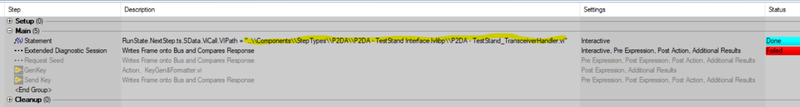

Exactly that's what I'm doing.  Since this property is not visible in editor, I use a statement before each step to update the next step property as below.
RunState.NextStep.TS.SData.ViCall.VIPath = "myNewPath"
