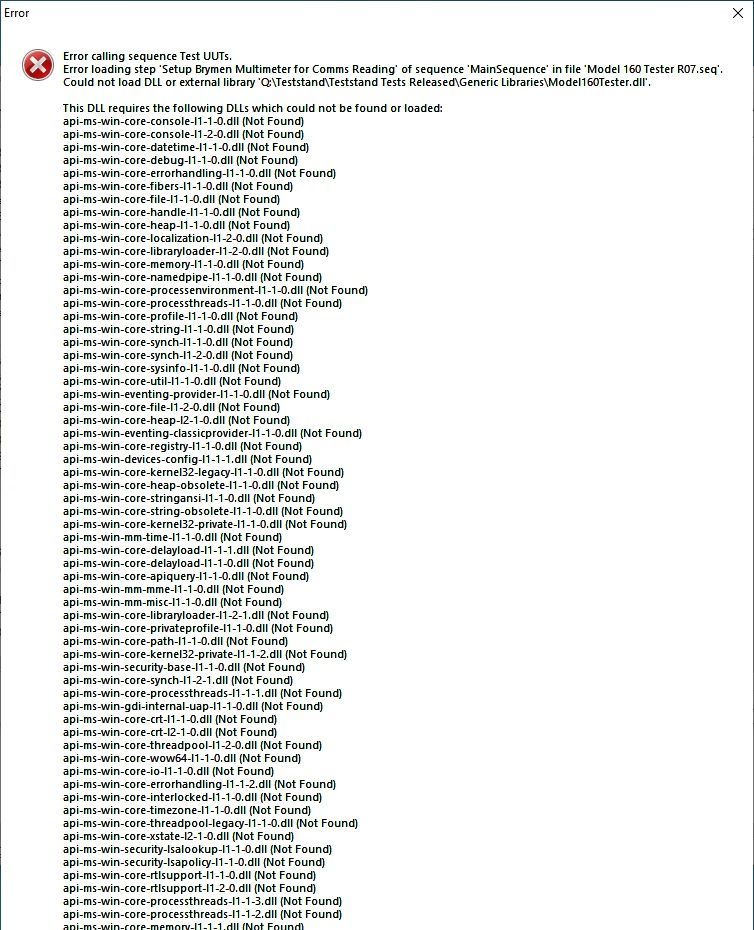

My problem is that on my windows 10 development system i installed 2014 SP1 and CVI 2015 i created a CVI DLL which uses the windows SDK but only for using Serial Comms and to find serial comms, and on the development system it work as expected. I then created a deployment of teststand 2014 sp1 with all the runtimes to deploy on different windows 10 PC but when i try to run the sequence i get the following errorerror.jpg
On the deployment system i do see the files in c:\Windows\system32\downlevel\ and c:\Windows\sysWow64\downlevel\ but i still get this error.
Can any one please tell why this is happening?
or how i can solve this?
