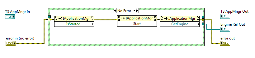

I have a working simple UI in LabVIEW and decided to encapsulate all the handling of TS into an actor (using the Actor Framework).
The trouble already starts when trying to start the engine.
The code I'm using is taken from my existing UI code (except the IsStarted Prop Node which is only for debugging). The PropNode executes fine (no error, IsStarted = False), the following Invoke Node fails with Error -17500.
So theTS AppMngr Ref seems to be valid... any ideas?

I found out in the meantime, that the code works, if the Manager Control is placed on the Actors' launcher VI (which is top-most and stays active) and the reference is send to the Actor.
It seems, it is not enough to place the control on Actor Core, although teh FP is active and execution is set to UI system....
What keeps me still suspicious is that (see above), the property node was executed without error while the following invoke produced on. Can anyone explain this behaviour?
