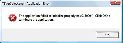

But when I opened the TestStand Version Selector, I'm getting the following error.
Please help me fixing this problem.

I'm not sure why you might be getting that error when launching the Version Selector. Would you mind opening TSVerSelect.exe in DependencyWalker and seeing what dependencies are missing?
Launch DependencyWalker (depends.exe), then go to File»Open and browse to TSVerSelect.exe. You can then save a .dwi file and you can zip up and post to this thread for us to look at.

From the dependency walker file, it looks like the mfc80.dll dependency could not be found. The mfc80.dll file is installed with the Microsoft Visual C++ 2005 Redistributable Package and should have been installed when you installed TestStand. It's possible that this file was not correctly installed or accidentally removed. Please try repairing the TestStand Version Selector and let me know of the outcome.

Microsoft Visual C++ 2005 Redistributable Package is installed in my PC. I'm not clear about how to repair the version selector exe. I uninstall ed TestStand and reinstalled it. But I still have the same error. I tried searching for that mfc80.dll, but couldn't locate it in my PC.  Also I couldn't locate  TestStand palette in LabVIEW.

I tried uninstalling and reinstalling the Visual C++ 2005 redistributable package. I still have the same error. I suspect it could be some registry problem. I was able to locate that mfc80.dll in the path C:\Windows\winsxs\x86_microsoft.vc80.mfc_1fc8b3b9a1e18e3b_8.0.50727.163_none_0c187ef99ee1d25a, but as you said that TS Version Selector was not able to locate that dll. Is there any other fix ? Or Should I reinstall my OS ?
