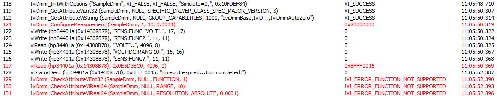

Here's the NI I/O Trace.
I haven't been able to figure it out. I am assuming that the demo was tested with simulated and real hardware so I am expecting there is something wrong with Ni-Max settings or ...? Thanks for any help.
