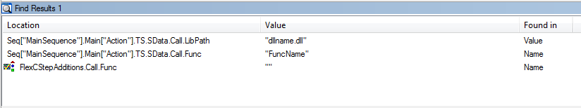

The ability to copy find results was added in TestStand 2014. If you have access to TestStand 2014 you can use it on older sequence files as well.
1) Do a find in Names and String values at least and enable Regular Expression searches and use the following regular expression:
{^Func$}|{dllname.dll}
^Func$ will match to the property name Func which will cause that property's value to show up in the find results list and dllname.dll will match the value of your dll name. You will then get results where if a function is in the dll it will be next to the dll name match. All function names will show up in the list though so you will have to ignore the ones that aren't next to the dll name. The list will look something like the following:
2) Another alternative is to use the Sequence File Documentation generator tool in the tool menu and search for your dll in there.
3) Another alternative is to write a program or sequence that uses the teststand API to search for the dll name at Seq[<sequenceindex>].Main[<stepindex>].TS.SData.Call.LibPath and if it matches give the function name at Seq[<sequenceindex>].Main[<stepindex>].TS.SData.Call.Func (don't forget to search Setup and Cleanup step groups as well).
