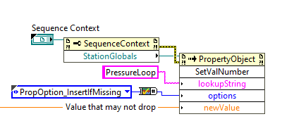

From what I understand, the While Loop is running in your TestStand MainSequence. The determining "output" is not actually a VI output, but a value inside the VI which will be regenerated periodically.
Now your issue is to get the current values from the VI to the MainSequence.
Since you preferred crossrulz #1 solution of using TestStand variables to pass the values instead of passing them LabVIEW internally, here is a little screenshot showing what he meant:
This code needs to be implemented into the VI that is generating the PressureLoop values. It will set the StationGlobals.PressureLoop numeric variable in TestStand with the current value without your VI having to stop. So the while loop in the MainSequence can read that StationGlobal while the VI is running in the parallel sequence.
Alternatives would be to change the VI to store the value in some sort of LabVIEW global variable (as crossrulz suggested), or to change the VI to finish executing after generating one value and looping the VI Call in TestStand. That way you can use the VI parameters normally to forward each value to the TestStand variable.
Either way you will have to change the value generating VI.
If this does not solve your issue, please give a more detailed description of what you are doing and trying to do and use the correct terminology. e.g. Globals.PressureLoop is very misleading. Is it a StationGlobal? FileGlobal? Weirdly named LabVIEW Global Variable?
