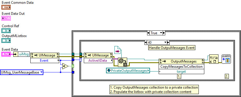

I'm not sure I fully understand the question. But, if you are looking for a way to display OutputMessage in your operator interface, it's a matter of UIMessage.
The OutputMessage is sending an UIMessage, so you have to register a callback on UIMessage (already done in operator interface examples) and to handle event code 40 (UIMsg_OutputMessages constant, see UIMessageCodes Enumeration).
I implemented something like that few years ago (TestStand 4.2.1). The callback VI looks like this :
I needed to get a reference to an OutputMessage (PrivateOutputMessage in global variable) from Engine with the NewOutputMessage Method. In the callback, you need to cast the ActiveXData to an OutputMessage object, and to use the method CopyMessagesToCollection.
The SubVIs that follow handle the copied messages to display them in a multi-column listbox (with dirty constant, oops...). In my case, the association icon / output message category is handled in the sub-VI that follow the node Item property on the OutputMessage reference :
See also the OutputMessage object for more details on available data.

Hello Mathieu,
I know this is an old thread but I am trying to do exactly the same as you do show in your code snippets.
Unfortunately I am running in some errors.
The CopyMessagesToCollection invoke node is throwing error -17500 in my tests.
I am also a bit confused since in your explanations you are talking about OutputMessage objects as your code snippets seem to be showing OutputMessages objects.
What exactly is the object inside your global variable and also the type you cast the ActiveX data to?
Thanks alot
Stefan
Message 6 of 9
(4,047 Views)
Not sure, I didn't reopen the code, but I think the OutputMessages reference stored in the Global Variable is get from Engine, with the NewOutputMessages Method. It's an empty collection that will handle the OutputMessage object you copy to it.
Hope this helps,
Message 7 of 9
(4,044 Views)
Hello Mathieu,
you are correct.
By creating a NewOutputMessages object and casting the ActiveXData of the UIMessage event to it, I could invoke the CopyMessagesToCollection method with my NewOutputMessages object as target and read out the output messages from the Item list afterwards.
Thanks alot!
