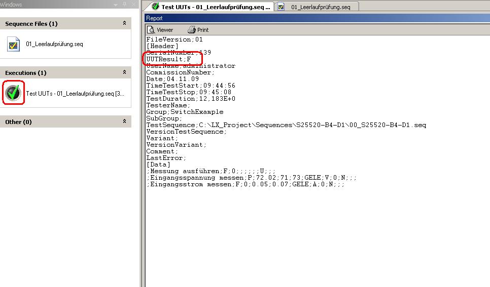

i tried the RunState.Execution.Terminate() Method in an Expression-Step in Case of a Failing Step. But the inidcator at the end of the test says 'Pass'. There is a conflict between the failing step and the result. See the screenshot.
What can i do?
