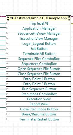

Hi, Can anybody please tell me ..which reference should i connect to access for the following properties of test stand UI.
If possible, please direct which ref i should connect to property node so that i can access these properties.
